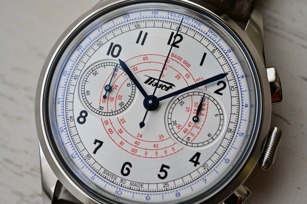

Just yesterday, Tissot introduced a lovely and affordable vintage-inspired chronograph, the Telemeter 1938. The watch’s bi-compax layout comes courtesy of a legendary chronograph calibre, one of the most widely-used movements in the industry, the ETA-Valjoux 7750. This precise, tried-and-tested workhorse was created in the early 1970s. In its 50-year history, the Valjoux calibre has naturally evolved, with different variants, functions, and layouts. The movement has also been updated in the frame of continuous optimisation, in particular, by incorporating modern technologies to evolve in synchrony with the times. This brings us here, with the calibre reference A05.231, the latest evolution of the 7750 that Tissot has incorporated in its lovely vintage-inspired watch.

Back to Tissot (another brand from the Swatch Group), the ETA-Valjoux 7750 is the cornerstone of their mechanical chronograph collections today, powering the brand’s watches while offering an impressive price-quality ratio – just below 2,000 Euros for the Telemeter 1938. Taking a look at the watch, it isn’t difficult to spot several evolutions on the movement side. First and foremost, gone is the traditional 7750 dial layout with 12-6-9 registers. Many brands are more inclined toward the ETA 7753 classic 3-6-9 configuration or in this instance, a balanced and vintage-inspired bi-compax layout. Turning the watch over, the movement also shows some of the evolutions implemented over the years.
