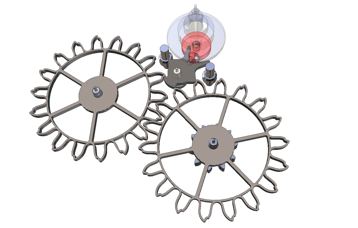

This latest version of the Freak has the same basic architecture as the very first, and which all Freaks have shared for nearly twenty years. The heart of the Freak is the minute hand, which is also the movement, and which sits on a carriage which is driven by the gigantic mainspring that sits directly under it. As the carriage turns, the movement/minute hand mounted on it turns as well. A gear at its tip rotates against fixed teeth under the bezel, transmitting energy down the gear train to the escape wheels. The last wheel before the escape wheel gears to one of the escape wheel pinions, and as the balance locks and unlocks them (via a small lever, which like a traditional lever escapement both acts to lock the escape wheels, and transmit energy to the balance) the minute hand/movement gradually advances around the dial.
The "Dual Ulysse" escapement, with double escape wheels.
The whole system is quite interesting to watch and has few parallels in modern watchmaking even conceptually (aside from Carole Forestier's later work with Cartier). The idea of a watch where the movement rotates inside the case is not a new one and ironically, it seems to have originated in a watch designed for economy: the Waterbury Long Wind, which was designed for the lowest possible parts count, had a nine foot mainspring, and which would sell for less than half of the cheapest watches of its time (the late 1880s; one example is in the Smithsonian Institute's National Museum Of American History). Though the principle is similar, in the Long Wind pure economy of manufacture was the goal, while in the Freak, the same idea has been developed to produce a particular aesthetic.
Except for the hour hand driving gears, the entire movement is mounted on a rotating tourbillon carriage.
The main going train bridge is skeletonized, and in the shape of a stylized anchor. The movement is caliber UN-205, with a one week power reserve; flying carousel tourbillon with Dual Ulysse silicon escapement.
From an historical perspective alone, the Freak is a significant watch, but part of the reason it has become so, and a modern classic, is that its aesthetic is, while no longer completely unique, still immediately identifiable and unmistakeable. Several versions of the Freak have been produced which use exotic materials to push the limits of what's possible in watchmaking from both a design and engineering standpoint (the Freak Innovision is one; the FreakLab is another) but the Freak Out is something of a counterpoint to such watches – there is little to distract you from the purity of the design and engineering, which seem particularly unified in this watch.
The two counter-rotating silicon escape wheels of the Dual Ulysse escapement.
Silicon has largely been used for its technical advantages, rather than its aesthetic potential, in modern watchmaking, but it does have some interesting visual properties as well – depending on the light it can be quite flat and very nearly disappear, especially against a dark background but at the right angle, its surfaces flicker to life, in most eye-catching blues and violets. This is somewhat reminiscent of blued or heat-purpled steel, and it gives the depths of the Freak a fugitive light, like the body of a carp appearing and disappearing in a garden pond. It's a very striking effect and, for the technically minded enthusiast, it also means you can clearly make out the very unusual shape of the escape wheel teeth, with their stylized ocean-wave profiles – an example of engineering constraints leading necessarily to beauty. Watchmaking at its best connects the two in a way very rare in modern manufactured objects.
