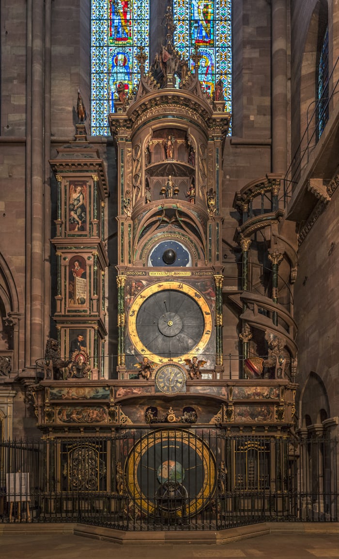

A method for calculating the Easter date is called a computus; is it possible to make a true mechanical computus, rather than relying on a program disk? The answer is, "sort of." The first true mechanical computus appears to have been made not long after Gauss came up with his algorithm, and it currently resides in a place more horological enthusiasts should know about: the great astronomical clock in the cathedral at Strasbourg, in Alsace, France. There have actually been three successive astronomical clocks there since about 1354, but the most recent was completed in 1843. Designed by Jean-Baptiste Schwilgué, it has a true mechanical computus – probably the first ever constructed. It's not the only mechanical computus, but I haven't been able to find anything in English on other computus devices (although a reprint of a review of a book on the Strasbourg computus mentions at least two other "similar" mechanisms).
Certainly it's the only one of its kind in terms of operating principles; I'm actively trying to research how it works but it's an uphill climb to put it mildly. The clock itself is a virtuoso piece of horology even without the computus – an article by Bryan Hayes, for Sciences, in 1999, mentions that there is a gear in the astronomical train of the clock that makes one rotation every 2,500 years, and that furthermore, the clock features a celestial globe that makes one rotation about an axis showing the precession of the Equinoxes only once every 25,000 years (the article was on Y2K compliance, and on how the Strasbourg clock is Y2K compliant with a vengeance).
The astronomical clock in Notre-Dame-de-Strasbourg Cathedral. (Photo: Wikimedia Commons)
Fortunately for the horologically curious (and maybe intellectually masochistic) you can see the computus mechanism – it's on display in a case at the lower left hand side of the base of the clock. You'll notice that among the otherwise gnomic assembly of gears is a display for the Epact of the current year, as well as the current Domenical Letter. The "Nombre D'Or" or Golden Number is the number corresponding to the current year's position in the Metonic cycle (one through 19, as shown) which is also necessary for the calculation.
Strasbourg clock computus. (Photo: Wikimedia Commons)
Once a year, on New Year's Eve, the mechanism comes to life. Its gears turn and, on the main calendar ring next to the computus – mirabile dictu – a metal tab changes position until it comes to rest next to the correct date of Easter for that year.
Schwilgué had made a model of the computus as well, which was stolen in 1945 and hasn't been seen since. However, clockmaker Frederic Klinghammer (1908-2006) who was employed by a company that at one time was responsible for the care of the clock, built a working model of the computus in the 1970s, and it's that model which is the basis for what modern information there is on how the Strasbourg cathedral computus actually works.
At this point you can understand why the trio who designed the date-of-Easter complication for Patek might have looked at each other and said, "Okay, guys, look ... let's just go with a program wheel." Modern fabrication techniques might make it possible to make a mechanical computus, based on Schwilgué's design, that would fit into a large wrist or pocket watch but my guess is that even with things like LIGA and silicon fabrication, it would be pushing it (though I'd kind of love it if someone would try). A 28 year program disk seems a reasonable compromise, even if replacing it with a disk for another 28 years probably involves non-minor surgery on the Caliber 89. The program disk is an unavoidable necessity as, if you use the current rules for calculating the date of Easter, a full cycle of Easter dates only repeats itself once every 5,700,000 years.
The Strasbourg clock appears to be built to be theoretically correct until the year 10,000 AD (the year indication goes to 9,999 and Schwilgué is supposed to have helpfully suggested that in 10,000, someone might paint in a "1" to the left of the year window). However, if the computus follows a 10,000 year cycle, it will output the incorrect date for Easter in 11,999. In that year, the computus will display the date of Easter as April 4th; in fact, the correct date will be April 11.
